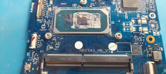

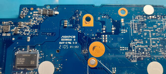

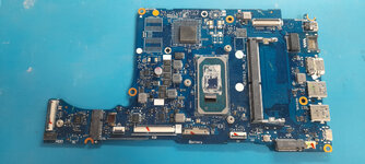

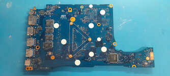

Acer Notebook Computer Model: N19H2
Acer A514-53-395P / Aspire A514-53
S/N: NXHUQSP005113008012N00
SNID: 113002049223
Issue: No Display
Attached Files: Motherboard images & Bios Bin file
Request: Bios Bin File
Thank you very much

good day madam
can i request for disabled on-board RAM
the laptop display is good but if the laptop turn-off, the display is unable. need to re-connect the CMOS Batt
and the display goes on
thank you :)
the bios bin file that you send is good, first after i'll flashed the bios bin file the display is good but after i'll shut down
for final assemble and turn-on the laptop won't display. i thought it's the same so i decided to write back the orig bios bin.
it's also the same the problem, once it's on and restart the display is okay.
