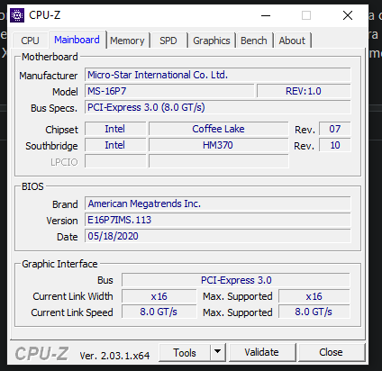

Hi, i want to know if the bios file include the DMI information because i need for example the information of realtek because my laptop no detect drivers correctly. I need a bios backup
octavio
It no work because this doesn't have DMI information, I need a backup. Can you help me with this?
At the moment, my laptop work unstable using this bios, my GPU no works correctly in games. The max percent of GPU use is 1% approximatly when it should be 50% or more. My laptop doesn't show audio adapter information. Windows Update want to install drivers of a Xenon, my laptop is lose without this information and it doesn't know how work correctly

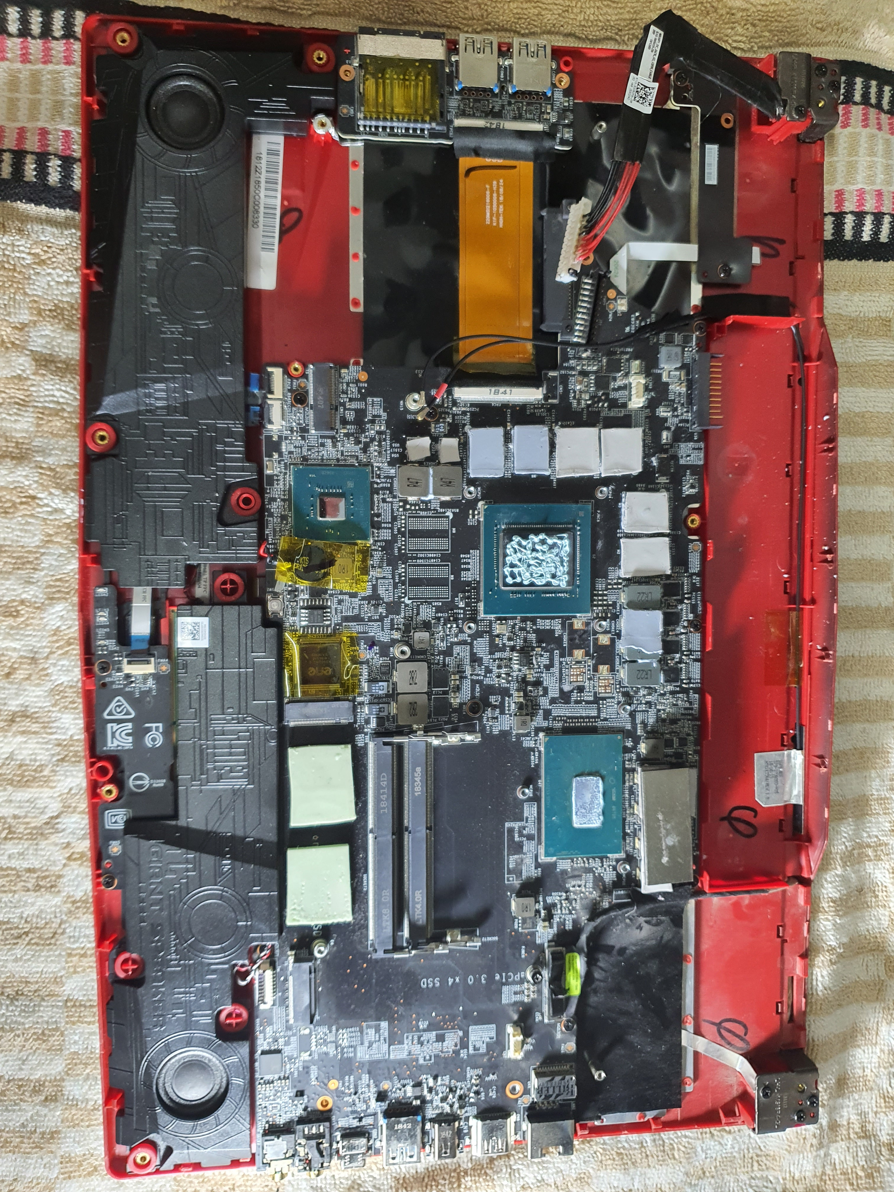

board model is ms-16p7 ?
check under all stickers and also under heat sink

seems this problem is not related to bios
you need to check all parts of motherboard
